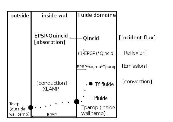

Radiative transfer boundary conditions
Sketch of thermal flux in boundary walls
The radiative boundary condition is based on the calculation of a new wall temperature. This temperature is computed with a thermal flux balance:
\[{ Q_{conduction} = Q_{convection} + (Q_{rayt_{absorption}} - Q_{rayt_{emission}}}) \]
Therefore :
\[ \dfrac{xlamp}{epap}  (T_{fluid} - T_{wall})
= h_{fluid}  (T_{fluid} - T_{wall}) + epsp  (Q_{incid} - \sigma * T_{wall}) \]
Note
In code_saturne the flux is positive when it is oriented from inside to outside.
