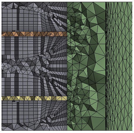

Regarding mesh inflation layers and joining. I attached the picture with mesh cross-section for the finned tube. There are tube wall, fins and air volume with inflation layer (marked with different colours). As I understand, Saturne can turn internal named slection into internal wall (boundary insertion in mesh preprocessing) but not to build inflation layers. Is there a function I’m not aware of? I cannot find layer parameters like first layer thickness and number of layers in Boundary insertion in Saturne GUI.
How joining errors look like. Ihave not ready joining filed (din’t keep non-conformal variants) but, if you look at the joining.case in Paraview, you will see that most of inflation (air) and tetra (fin metal) faces are joined, while there are some “holes”. Joiner cannot understand “flat” pyramids of the first inflation layer contacting with tube fin metal tetras. Maybe it’s algorithm limit that cannot be fixed. The mesh itself is good, CFX runs on it.
Yes, code_saturne can build inflation layers, though the handling of “sliding” conditions for faces near to but not adjacent to extrusion layers needs to be improved.

About your issue with intersecting layers. It’s indeed one of known problems. There are two options: layers compression and layers stairstepping (gradual reducing number of layers near collision zone). As I can see, you used stairstepping, but compression is more universal. Stairstepping may be used if only solver supports arbitrary adjacent cell size ratio because, in practice, you will have a “thick” tetra connected to a very thin prism in area with reduced number of layers. CFX can do it, but, I think, it’s too complex for Saturne (older versions can’t cope with such growth ratio and diverge inspite of relaxation, similar thing is for Fluent: no fully coupled velicity|pressure - no support for very bad mesh). Anyway, this mesh will not be of good quality (yes, we use such with CFX if there is no other way, but it’s a “dirty method”).
Again, inflation is a hard task for arbitrary geometry. It’s normal that basic mesher will not be able to layer arbitrary geometry. Important thing is to correctly point what exactly was a culprit to allow user to fix or simplify geometry in problematic zone.

Regarding compression vs stairstepping, we would also have numerical issues with compression, especially if that leads to very thin boundary layes in curved zones. So we try to have a “practical, easy to use” boundary layer insertion mesher, not a universal one. Since our algorithm compresses the mesh to insert layers, this will degrade cell quality, especially if the layers are thick. So in most cases, unless you are taking advantage of the fact that building the boundary layer inside the computation can allow adapting th layer thickness to the turbulence and wall law model, it is better to insert the boundary layer upstream. But when that is too difficult, users have a backup option in code_saturne.
