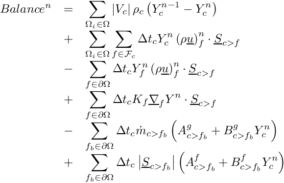

The algorithm implemented in the subroutine balance_by_zone adds up contributions of fluxes on the boundary of the sub-domain defined by the user. The different contributions are classified according to their nature (inlet, outlet, wall, symmetry...) if they are boundary faces of the whole domain or according to the sign of the mass flux if they are boundary faces of the sub-domain but internal faces of the whole domain.
To ensure calculations have physical meaning, it is best to use a spatially uniform time step (idtvar = 0 or 1).
The balance at time step n over a subdomain $ \Omega $ of boundary $ \partial \Omega $ is equal to:
\begin{array}{r c l}
Balance^n &=& \displaystyle
              \sum_{\Omega_i \in \Omega}
                \norm{\vol{\celli}} \rho_\celli
                \left(\varia_\celli^{n-1} -\varia_\celli^n \right)  \\
         &+& \displaystyle
             \sum_{\face \in \Face{\celli}}
                \Delta t_\celli
                \varia_\celli^n \left(\rho \vect{u}\right)_\face^n \cdot \vect{S}_{\iface} \\
         &-& \displaystyle
             \sum_{\face \in \partial \Omega}
                \Delta t_\celli
                \varia_\face^n \left(\rho \vect{u}\right)_\face^n \cdot \vect{S}_{\iface} \\
         &+& \displaystyle
                 \Delta t_\celli
                 K_\face \grad_\face \varia^n \cdot \vect{S}_{\iface} \\
         &-& \displaystyle
             \sum_{\fib \in \partial \Omega}
                \Delta t_\celli \dot{m}_\ib
                \left(A_\ib^g + B_\ib^g \varia_\celli^n \right) \\
         &+& \displaystyle
                \Delta t_\celli \norm{\vect{S}_\ib}
                \left(A_\ib^f + B_\ib^f \varia_\celli^n \right)
\end{array}
The first term is negative if the amount of scalar in the volume has increased (it is 0 in a steady regime).
The terms of convection and diffusion (at internal or boundary faces) are positive if the amount of scalar in the volume has increased.
In a steady regime, a positive balance thus indicates a scalar gain.
