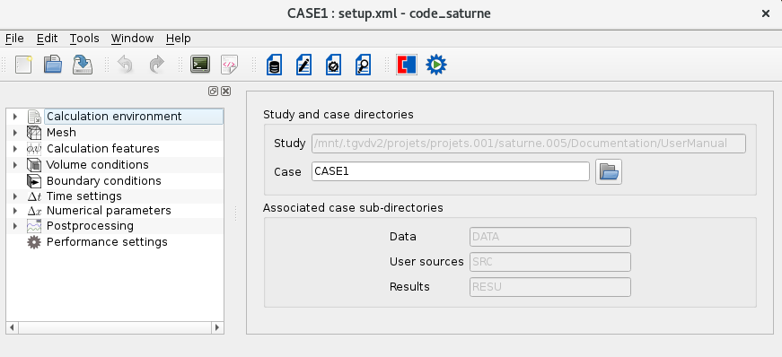

The mesh files should be copied in the MESH directory (though they may also be selected from another directory (see [sec:prg_stepbystepcalculation]) and the C++ or C user files necessary for the calculation in the directory CASE1/SRC. Finally, the calculation data file setup.xml managed by the GUI should be copied to the CASE1/DATA directory. Once these steps are completed, the user should go in the directory CASE1/DATA and run ./code_saturne gui setup.xml to load the calculation file into the interface. A window similar to the one below will appear.

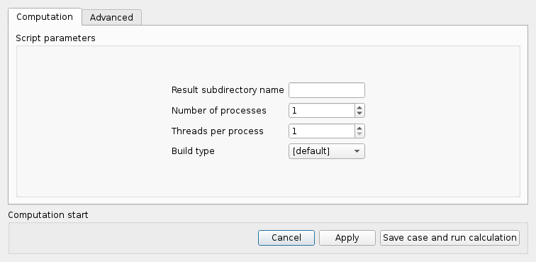

Click on the "Run computation" button in the toolbar, as shown below. After having chosen the number of processors, press "start calculation" to run the calculation.
