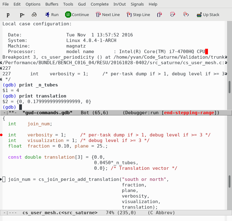

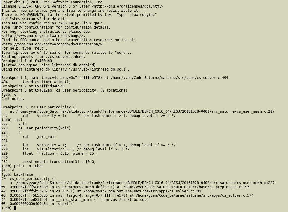

When used directly, GDB runs in a single terminal frame, as shown here. Only the current line of code is shown, though the list command allows showing more.
GDB in terminal mode

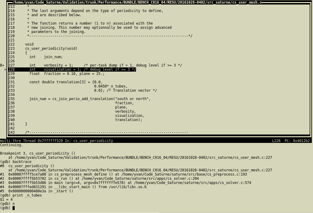

When started with the -tui option, GDB runs in a split terminal, with source on top, commands on bottom.
  • Using the CTRL+x+o key combination allows changing focus from one to the other.
  • Using the CTRL+l key allows refreshing the display.
  • Using the CTRL+x+a key combination allows switching back to the single temrminal. With recent gdb versions, it is no possible to copy or paste text from a split terminal, but is it possible from a single terminal, so switching back and forth may be useful.
GDB with split screen
GDB may also be run under Emacs, which provides syntax highlighting of source code.
GDB under Emacs
GDB base commands
Checking the gdb documentation or tutorials is recommended. The most important gdb command is:
help
The most commonly used commands are:
  • b: set a breakpoint.
  • c: continue.
  • p: print a variable's value (using the current programming language syntax).
  • up: move up the stack.
  • down: move down the stack.
A running program may be paused using CTRL+C.

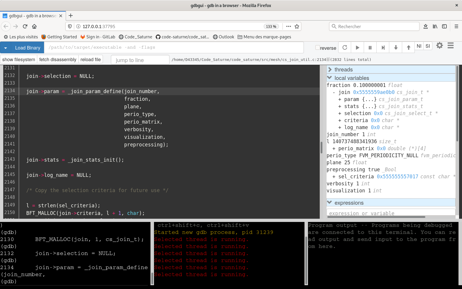

The gdbgui debugger seems promising, and a good potential successor to DDD. It is based on a web-browser interface,
gdbgui

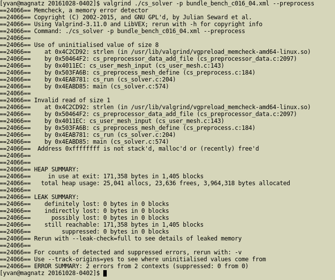

The Valgrind tool suite
The Valgrind tool suite allows the detection of many memory management (and other) bugs.
  • Dynamic instrumentation
    • No need for recompilation
      • Usable with any binary, but provides more info (i.e. code line numbers) with code compiled in debug mode
      • Depending on tool used, run time and memory overhead from 10-100x.
        • With default tool (Memcheck), 10x30.
        • Use proactively, to detect bugs on small cases, before they become a problem in production cases.
Valgrind is easy to run:
  • Prefix a standard command with valgrind
    • By default, uses the memcheck tool.
    • Tool may be changed using valgrind –tool=/cachegrind/callgrind/drd/massif/...
  • Valgrind may be combined with GDB using its gdbserver mode.
    • To use this mode, call valgrind –vgdb-error=<number>
      • The number represents the number of errors after which the gdbserver is invoked (0 to start immediately).

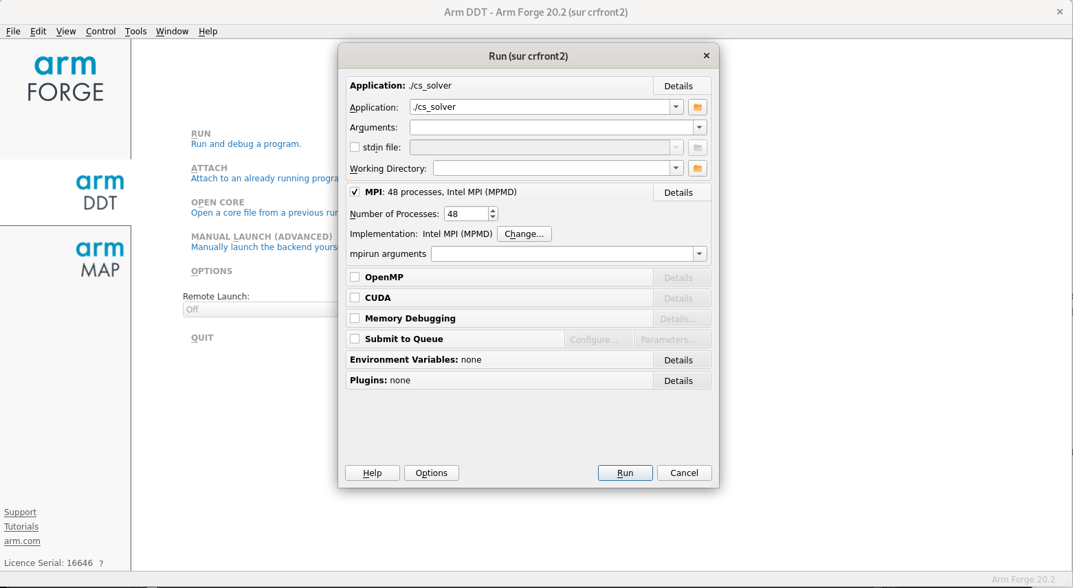

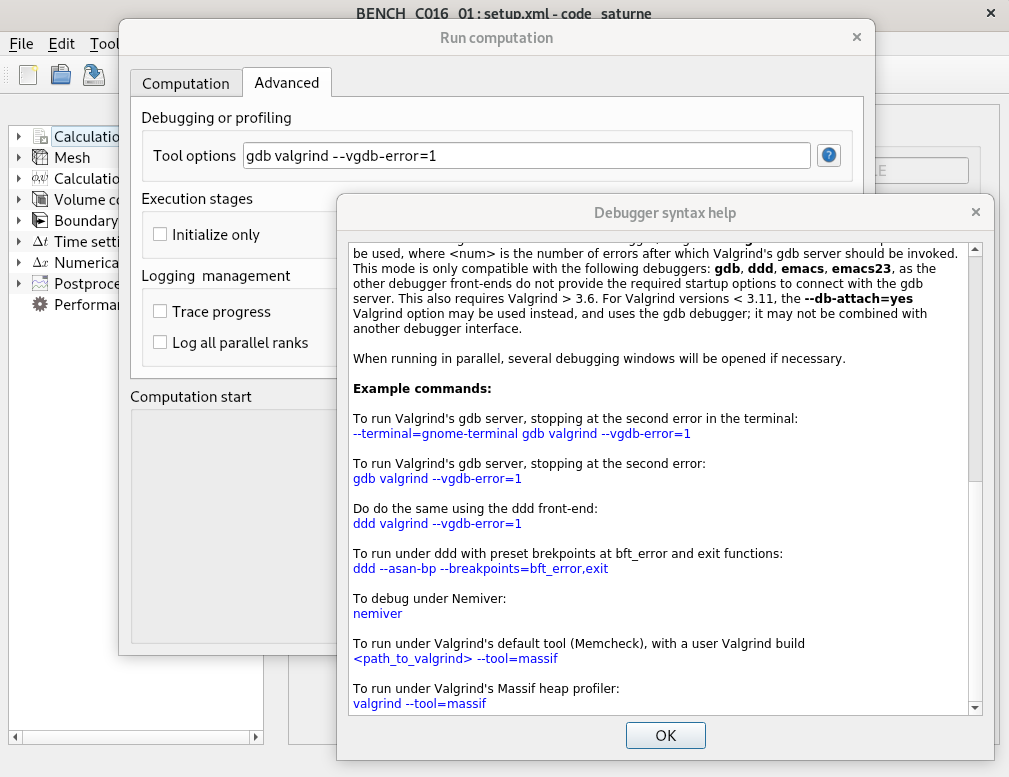

Starting the code_saturne solver under a debugger
Several ways of setting code_saturne to run under a debugger are possible:
  • Using the GUI, set options in Run computation/Advanced options`
    • The associated help provides several examples
    • This sets a debug_args option under the current resources section in the case's run.cfg file, which can also be edited directly.
  • The same options can be provided directly to code_saturne run using the --debug-args option
Example of use of debugger wrapper
When the code is run, the debugger will then be launched automatically.

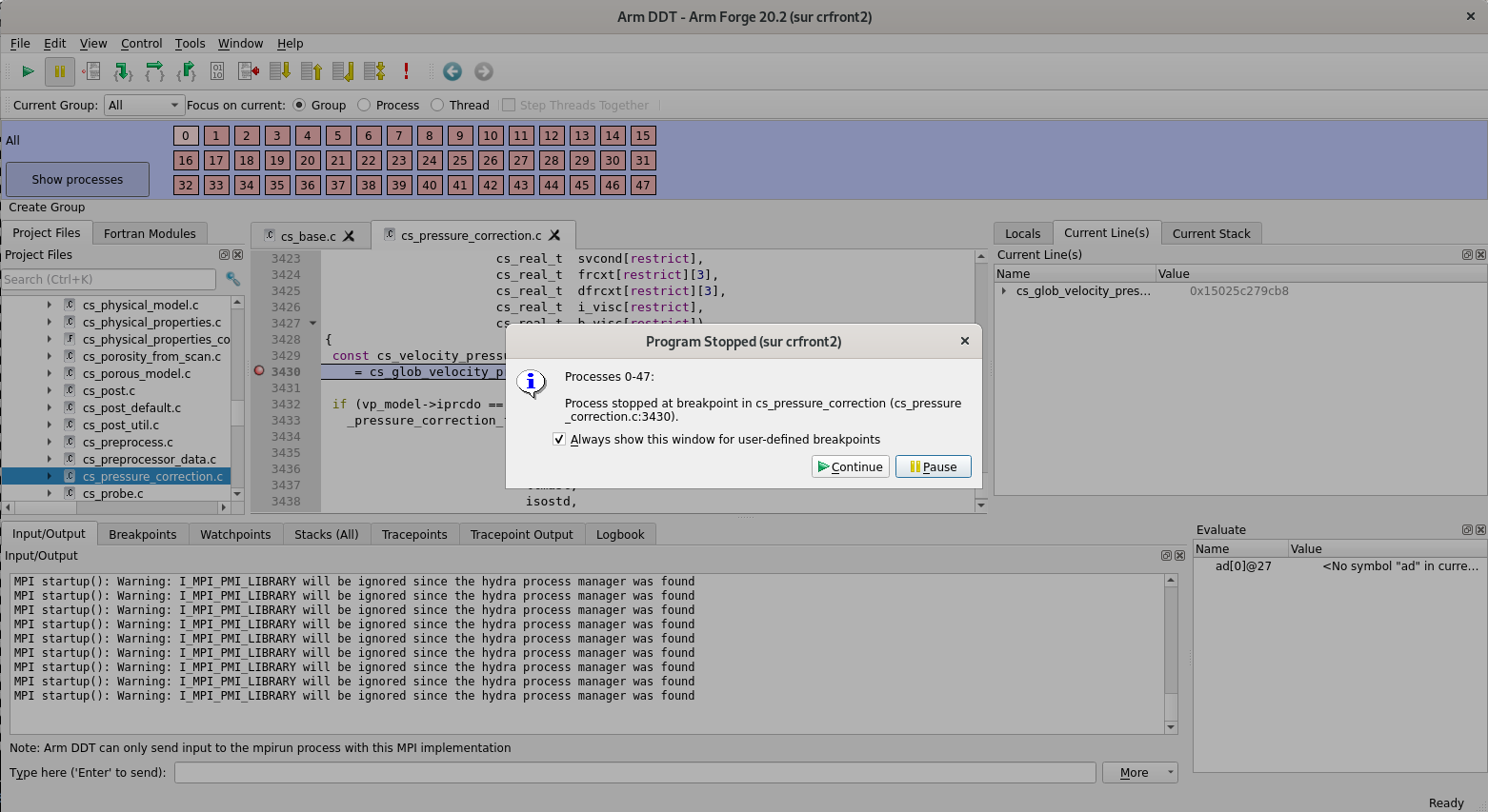

The following debuggers and user interfaces are handled: gdb (GNU Debugger), cuda-gdb, cgdb (console-front-end to gdb), gdbgui (browser-based frontend to gdb), ddd (Data Display Debugger), emacs (as gdb front-end), kdbg (KDbg), kdevelop (KDE developement environment), gede (simple Qt-based gdb GUI), nemiver (GNOME Nemiver debugger), valgrind (Valgrind tools for memory debugging).
If a debugger may not be found in the PATH, an absolute path should be given instead.
The following debug wrapper options are handled:
--asan-bp adds a breakpoint for gcc's Address-Sanitizer
--back-end=gdb path to debugger back-end (for graphical front-ends)
--breakpoints=LIST comma-separated list of breakpoints to insert
--ranks=LIST comma-separated list of MPI ranks to debug
--terminal terminal type to use for console debugger
Other, standard options specific to each debugger may also be used, as long as they do not conflict with options in this wrapper
To combine a Valgrind tool with another debugger, Valgrind's --vgdb-error=<num> option should be used, where <num> is the number of errors after which Valgrind's gdb server should be invoked. This mode is only compatible with the following debuggers: gdb, gdbgui, ddd, emacs, as the other debugger front-ends do not provide the required startup options to connect with the gdb server.
Note that compared to a standalone use of the gdb debugger, running under the debug wrapper automatically sets breakpoints at program start and end and launch the program.
To define commands such as setting breakpoints, a small gdb script with the .gdb extension is generated for each rank. It can be removed safely after program start.
When running in parallel, several debugging windows will be opened if necessary.
Example commands:
To simply run using the gdb debugger:
gdb
To run Valgrind's gdb server, stopping at the second error in the terminal:
--terminal=gnome-terminal gdb valgrind --vgdb-error=1
To run Valgrind's gdb server, stopping at the second error:
Do do the same using the ddd front-end:
ddd valgrind --vgdb-error=1
To run under gdb with preset breakpoints at bft_error and exit functions:
gdb --asan-bp --breakpoints=bft_error,exit
To run under gdb with a breakpoint for ubsan (UndefinedBehaviorSanitizer):
gdb --asan-bp --breakpoints=__ubsan::Diag::~Diag

    • Run cs_debug_wrapper.py --help for instructions.
  • The XML file may be modified directly using code_saturne gui <file> (ignoring the directory warning).
    • If mathematical expressions are modified, and additional step is required. in this case, it is simpler to generate a new run.
  • When modifying user-defined functions, do not forget to run code_saturne compile -s src_saturne to update the cs_solver executable.

Using a parallel debugger
If a true parallel debugger such as TotalView or Arm is available, the following procedure may be used:
  • First, initialize the execution directory, using one of the following methods:
    • From the GUI, in the advanced run/job submission options, check "initialize only", then submit the computation.
    • Outside the GUI, run code_saturne submit --initialize In either case, the code will prepare the execution directory, and preprocess the mesh if needed, but not remove the executable and temporary script.:
  • Once the stage has finished, cd to the execution directory, and edit the run_solver script script:
    • Add commands necessary to load the debugger's environment. For example, on the EDF Cronos cluster, this requires adding
      module load arm-forge
      in the section where other modules are added.
    • Search for the line actually launching the solver, near the end of the script; before the cs_solver command, insert the debugger command. For example, for the DDT debugger, replace
      mpiexec <options> ./cs_solver
      with:
      mpiexec ddt <options> ./cs_solver
  • If using a batch system, request an interactive allocation (for example, using salloc with SLURM). ** This step is important: without this, you may be trying to run a large job on a front-end node, and your cluster administrators will not be happy.**
  • You can then run:
    ./run_solver
    which will launch the code under the interactive debugger.
Debuggers such as DDT allows to easily switch between global and local stepping through the program and exploring its data, using a single window, as illustrated in this screenshot:
Global DDT pause
Remarks:
  • On some clusters using srun as the configured mpiexec command, the srun command configuration may not be compatible with DDT. In this case, switch to another appropriate mpiexec command.
  • In case launching the debugger fails, an alternative option is to simply replace the whole launch command (the line containing cs_solver) with the command launching the debugger's GUI, for example
    ddt
    And then simply follow the debugger prompts for command launch options, as shown in the example below.
    Example DDT launch options
